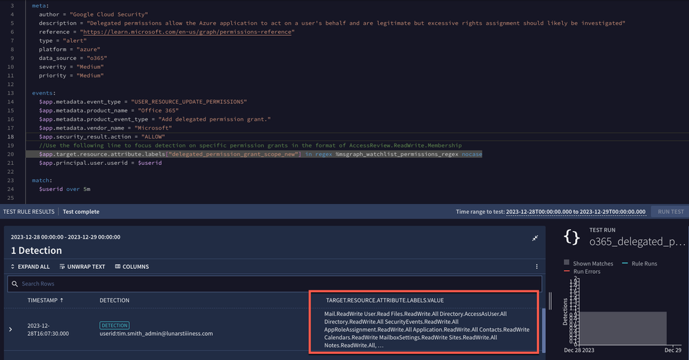

We could resolve this through placing the case insensitivity flag inside the regex list, essentially saying we don't care how the pattern matches from a case sensitivity perspective and when we do this, here is what we get back.
When it comes to rules, we have a few more options available to us because we have the convert to upper/lower functions in addition to the regex case insensitivity tools.
Option 1 - Use the same capability as the example in search (?i) in the regex list for each entry
Option 2 - Remove the (?i) case insensitivity flag from the individual lines in the regex list and just append nocase to the end of the rule criteria (this is an example where we want to better align search and rules)
Option 3 - Use the conversion functions (upper or lower). This does make an assumption that the list is all upper or all lower.
