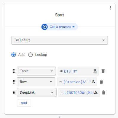

STEP 4 ---> Added FIrst Step in all the BOTs to be monitored as START
STEP 5 ---> Added Last Step in all the BOTs to be monitored as END
