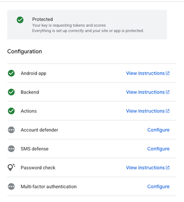

If so, this is the key I try to use:
I'm certain I don't use the old key from Safetynet for the new recaptcha Enterprise client. You can see that the key I mentioned is displayed as correctly integrated. It is working fine, but not on the builds that are signed by Google Play. On my local builds (staging/production and release builds) it works fine.
I looked through the logs for events related to that sitekey or related to your package name.  I see lots of "no network" errors from your roboelectric tests, and some success from an emulator, but no exceptions for bad sitekeys.  There are less than 100 attempts to init the SDK.
