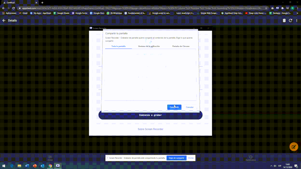

Hello again friends, i have several child tables that reproduce this behavior:
18 seconds gif (3.7 mb)
It happens when i add an item to a child table directly from the detail view of a parent table, it looks like it saves the rows without the parent ref:
Contratista_Id Obra_ref Nombre Rubro Nombre+Rubro RUC Telefono
9fc7f6cc someone someone ()
Which is quite bamboozling to me, since i can see it loads the reference on the form the moment i click the action that adds a new item, any ideas for fixing this? 3X_7_a_7a0214a097af7f0e8cacd8cade86bbf4c57663a4.gif
1 8 313
Well, i just realized i had the โ€œEditableโ€ box unchecked for the column containing the reference in the child tableโ€ฆ
It works nowโ€ฆ
I am clevernโ€™t, thanks for the help guys @Steve @MultiTech_Visions

I have done quite a lot of testing, and after i click on the new child row i just added from a parent table, i can see the new entry has a parent ref saved, but as soon as it syncs it disappears from the table, and lands in the spreadsheet without a parent ref.
Two questions:
  1. Have you adjusted the Add action at all? (for the child table)
  2. Is the Ref to a regular table, or a slice?
Hey Matt! thanks for replying, as for the answers to your questions:
  1. I have only changed the โ€œdisplay nameโ€ for the action
  2. The ref is to a regular table
Okay, thatโ€™s helpful.
Is there anything funny with the ref column on the child table? Something weird with the Edit If maybe?
Or is a workflow involved?
It works nowโ€ฆ
Thatโ€™s bitten me before, too.
Itโ€™s usually something strange like this - one off, never do it, strange why you did it this time but I did it and itโ€™s messing things up type of thing.
