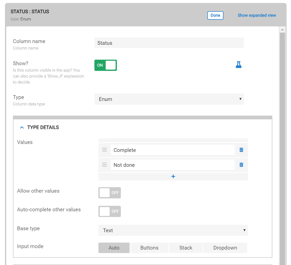

It will display in alphabetical order but when there is no data for a category it will skip that one, so for example if all of your statuses are “Not Done” it will incorrectly use the first color instead of the second. There is no way to set the color dynamically like you want (but that seems like a reasonable feature request).
To workaround this, I recommend you change your label type to an enum and be sure to add the two options: “Complete”, “Not Done” then the color order should always match even when one of the categories is empty.
Like this:

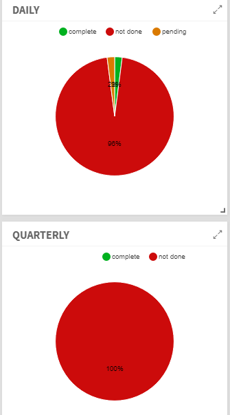

@nico, apologies for the late response, I didn’t see your post come through. My understanding is the same as yours - alphabetical order. However, that is not the behavior I’m seeing in my app - at least not at the start of the day. At the start of the day, our daily tasks haven’t been done yet, so I would expect to see a pie chart that is all red in color and labeled “not done”. Instead, I see a pie chart that is all green in color and labeled “not done”.
As tasks are completed and both “complete”, and “not done” appear on the graph then the colors and labels match up.
Any thoughts? again, apologies for the very late reply.
Like this:
@nico thanks! Enum column type works a treat. Why does this work and text columns doesn’t?
The reason is with that a enum has the complete list of statuses whereas the text type it guesses by looking at the data in the spreadsheet. When they are all the same it will assume there is just one status when there are in fact two but one of them (“complete”) has 0 entries.
At any rate, I’m glad this worked for you!
